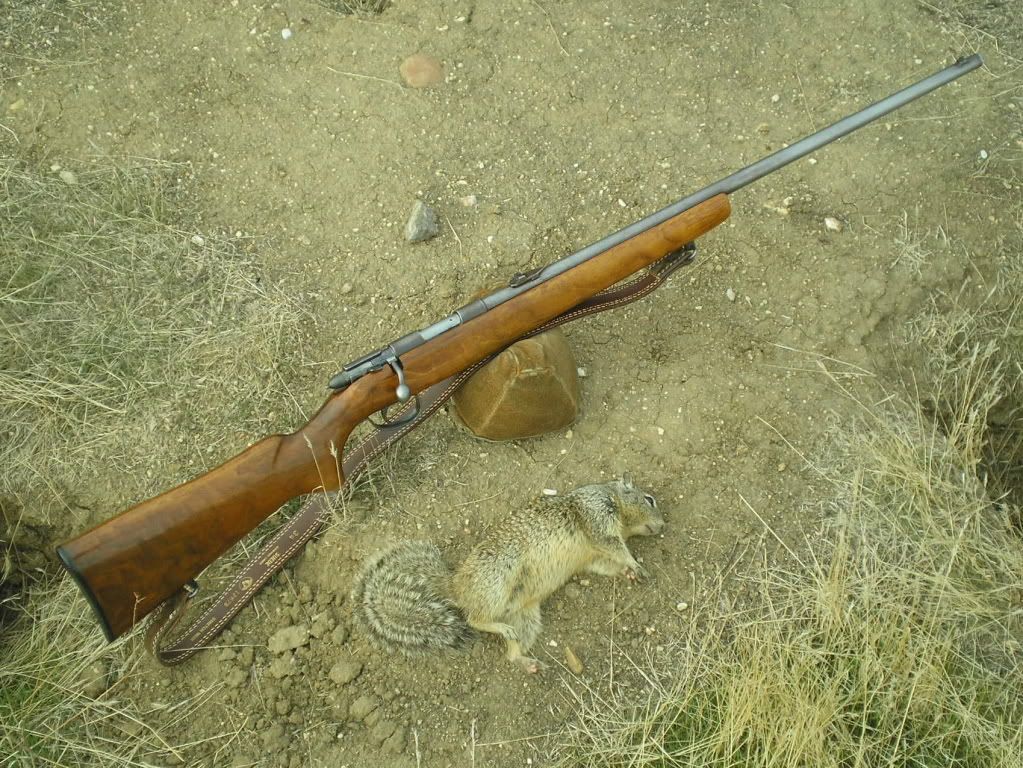

so, now what im left with possibly doing the small bore match with my Remington 521-T Junior Special that was handed down to my father from his dad, then it was handed down to me. It's a great shooting rifle for as far as the naked eye can clearly see. I shot a ground squirrel at 120 yards off of a sandbag rest on a bench once. I got right on him, then held over about a foot and hoped he didnt move, then i squeezed the trigger and i heard it thump him, saw him flop and squeal a bit and that's all she wrote for that little guy.

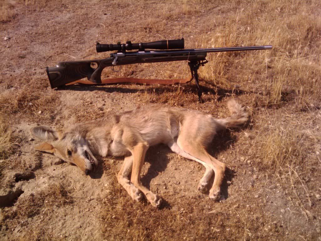

Rem 700 varmint with lam thumbhole stock in 22-250 with a Jewell trigger(wears a Leupold LR 6.5-20 scope). 1/4-1/2 MOA @ 100 yards consistently with 55gr Vmax handloads off a bipod and rear rest.

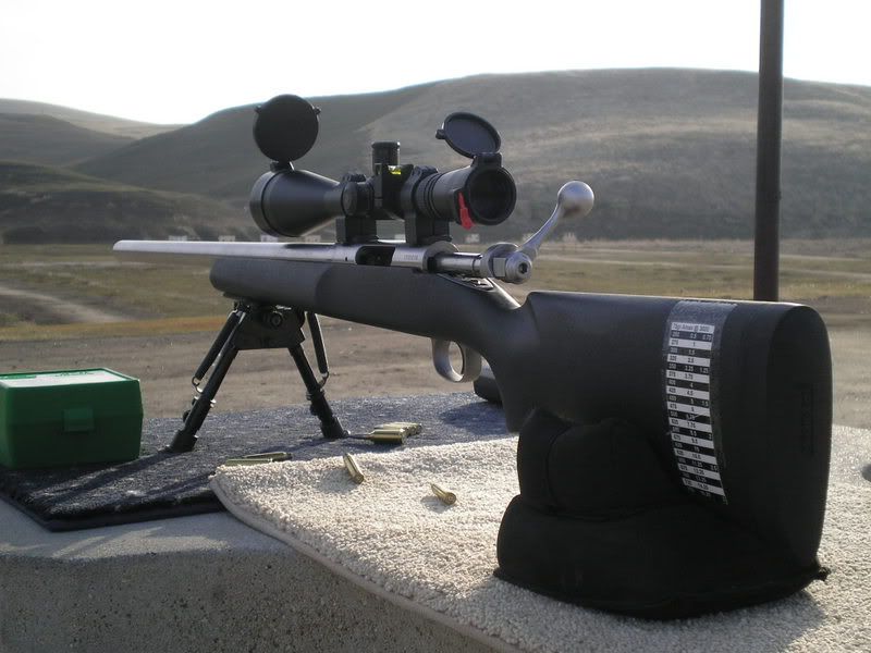

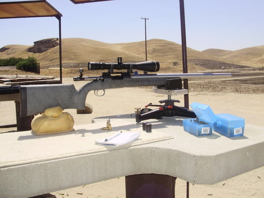

Rem 700 (built by JPG rifles who is a site sponsor) in 6br, 28" bartlein 5R barrel 1-7.5 twist contoured 1.25" - 1" straight taper (Leupold 8.5-25 LRT), jewell trigger, HS tactical stock with vertical grip.

the Rem 521-T with the iron sights and a couple of magazines for it.

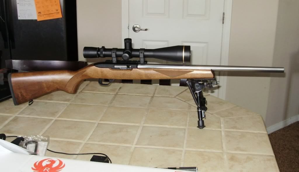

i also have a Ruger 10-22 light varmint (produced by accusport).
