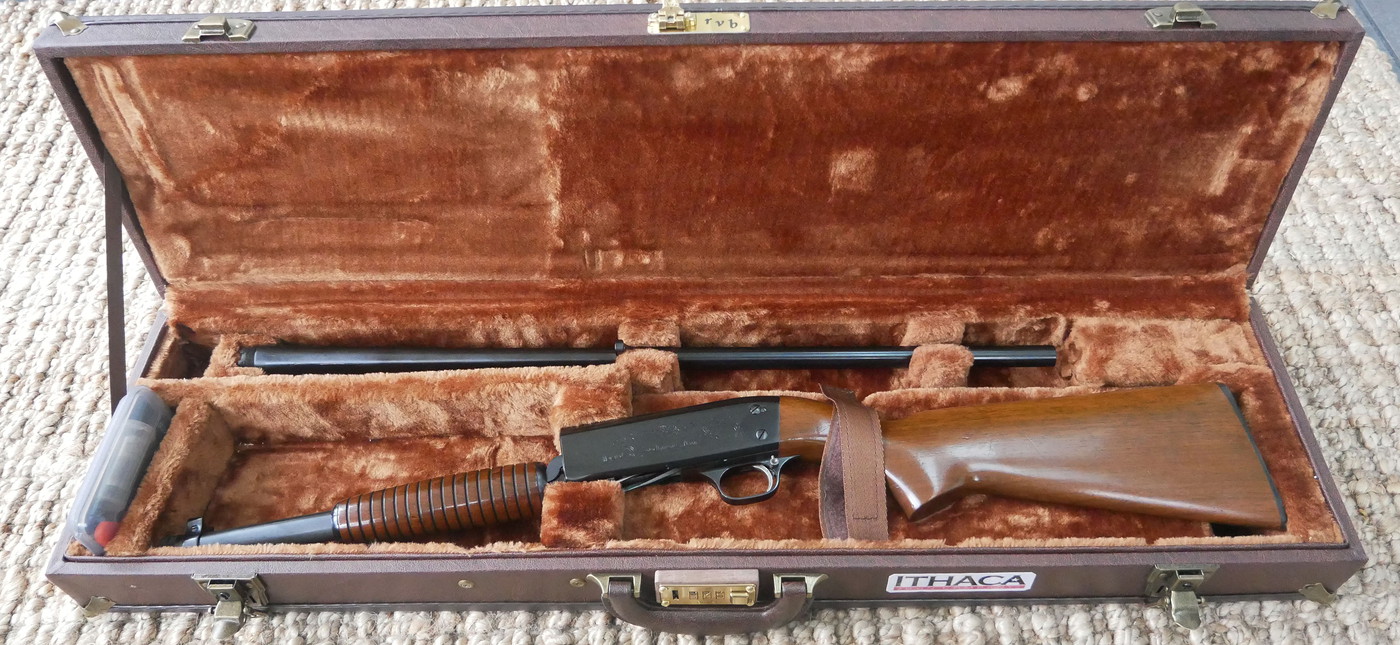

Ithaca 37 restoration

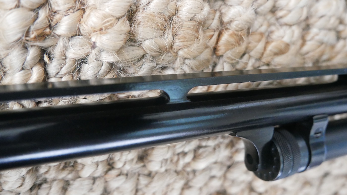

I had an old Ithaca 37 that needed love....and removable choke tubes and a ventilated rib.
Wrote an article about the journey on my web page

What choke tube system did you use? Tru choke or thinwall tru choke?
I’m about to do the same to a 12 and 20 gauge Ithaca
Thin wall TruChoke as this muzzle was very thin.
Trust me, I'd much rather have a nice rust blued or hot blued gun. I simply don't have the facilities to hot blue or the patience to polish a barrel to be blued.
This gun will be used as my "Rainy Day" gun as now it is nearly totally weatherproof.
