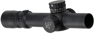

Finding a good scope for a revolver is tough. Leupold & Burris are the front runners. I currently have a Burris 3-12 and the eye relief changes anytime you change the power setting. Leupold does not change.
If a scope could be purchased similar to the style like the one shown below, a shooter would then have a great scope. This scope offers a 30 mm tube, exposed adjustable turrets, turret return zero, overall length of 8.75" and a weight of 17 ounces with reticle choices. Compared this to the Leupold at 11.4" in length and 10.9 ounces and Burris is at 10.8" in length and 16 ounces in weight. Leupold & Burris both have 1" tubes, no 30mm or 34mm available. The turrets are covered on both and no choice of reticle.
There is no reason to contact any of the scope companies since they will not discuss it nor would there custom shop discuss it either. They claim there is not enough market for a scope like this.
