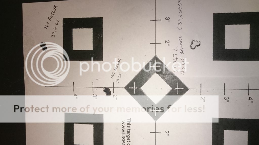

Rifle from a forum member on a different forum, the synthetic version is also very popular
file.php
file.php
Sort of groups during load work up @ 110y. 3 x 4 shot groups
