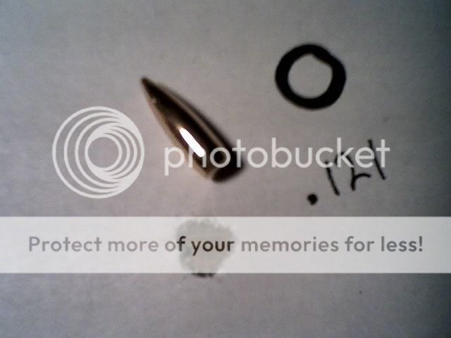

Here are some of my groups I shot yesterday with the load info written on my test target,alone with chrono speed). Hope you can read them... if not, look for my new post titled "204 powder and pressures".
Another trip to the range early this morning, no wind), this time with H335 powder loads. I guess what I find most frustrating about the 204 is the complete lack of consistancy/ example: with 32 gr. Sierra, .643", 1.486", .928", .932. With 35 gr. Berger, 1.261", .536". With 39 gr. Sierra 1.119", .678". All 5 shot groups at 100 yd. With the other cartridges, mentioned above, my groups will be consistant sub MOA, with a varity of different loads, and to the point of being boring. My 222s' and 223s', even my AR-15s'), will "whup" the 204 each and every time-- not even close. Am considering using up the components, not buying any "new", and sometime in the future, near?), getting out of the 204 business. So far, has been a disappointment.
