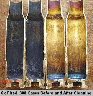

The other method, if you want to really get your cases clean INSIDE and out, is to use ultra-sound. It works great, but is a more time-consuming process. Here is Jason Baney's report on ultra-sonic case cleaning.
http://www.6mmbr.com/ultrasonic.html
