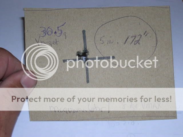

I've been doing some load work on my new Savage 6br build, using Varget and 87gr vmax for a varmint load.
Since the load window is 29-31gr I guess it's easy to say that 30gr is 'magic'. Mine was close to that, as I have settled on 30.3gr as my charge for this bullet. I have run the ladder a few times testing each charge, and this one was always the tightest. 30.0 and 30.5 were not quite as good but had the same poi,so it works out. All the loads were under 1/2' @ 100, but the 30.3 is 1/4',with a best so far of .172').
The target says 30.5, but it was actually 30.3
