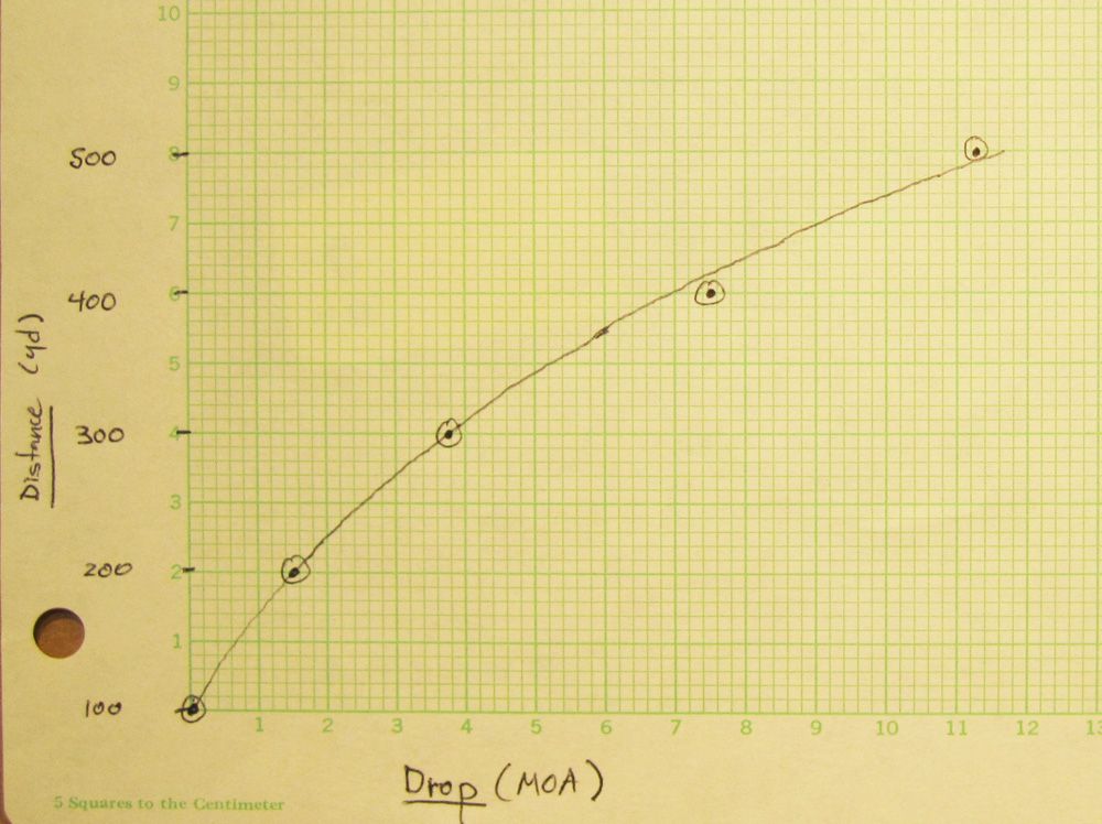

The most common reason people's actual drops don't match exactly with those predicted by a ballistic calculator typically has to do with the input data, as suggested above. Bryan was very kind to provide you with the solution, but there is a pretty simple method for anyone that has graphing software. Mathematically, the trajectory of a bullet should be closest to a parabola. If you plot your actual data in any programmable graphing software, input the equation for a parabola as the function, and have it plot the best line through your actual data, you can extrapolate the answers you want, at least to as fine a degree as most can likely shoot, because there are no "predictive" ballistic elements required; it's simply a graph of your actual distance vs drop data. Alternatively, you could do the "old school" method, which took me about 2 minutes by hand with a piece of graph paper :). Using this little graph, I estimated the following drops per your original post:
225 yd - 2.0 MOA
375 yd - 6.0 MOA
450 yd - 9.0 MOA
I'd be curious to hear back how these values compare to those you obtained using the Linear Interpolation Equation Calculator. The obvious advantage to doing this type of an exercise electronically is that you can solve for any intermediate value, which may be a little more challenging to estimate from a hand-drawn graph for very fine or unusual increment yardages (i.e. 373 yds). However, the difference in drop over a 5 yd increment is not likely to be one that you can reproducibly shoot.
225 yd - 2.0 MOA
375 yd - 6.0 MOA
450 yd - 9.0 MOA
