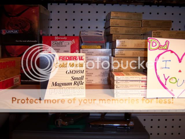

I am not really asking anything here except maybe if anyone has experienced such a velo spread before and maybe what powder i should try next. I just thought this was pretty interesting to see the numbers so scattered. I havent ever experienced this before, and i am not real sure how to make heads and tails of it. One more thing just came to mind. The primers i used are some older federal 205 magnum. I have been told these primers do not exist, but they do. I have about 500 of them, and thought i would use them up for hunting purposes. I hope i havent bored you fellas with all this. I am sure some of you all have seen this before. I love learning, and this is just another learning experience. Now what to do next is i guess the question. Thanks for reading! Lee
before you unscrewed the barrel off the rem 700, did you use these same primers with that varget load as you did this time?
No i didnt use the same primers. I was told that the magnum federal were the exact same as the now 205m match primers. I thought they were going to be the same. Maybe they are not. And yes for the millionth time, they are magnum federal primers. LOL!!! They really are. I was thinking about that last night so i loaded up 10 more varget loads with my newer match federal primers. I will post my findings. I will post a pic of the magnum primers. Thanks guys lee

Thats what i was kinda thinking myself, so i did. I went back to the range last night and the results were much better. I didnt use Varget again though. I used Benchmark instead. The numbers were much more consistent. The accuracy was much better as well. I did use the fed magnum primers though. I dont have enough of these to use for my comp guns, so i thought using them up in my hunting rifle made good sense. I loaded up some 80gr berger varmint bullets. I loaded five to set in the lands and 5 15thou off the lands. The loads that were off the lands 15 thou shot the best. I did notice that the velocity was higher with the loads off the lands as apposed to the loads that were in the lands. (same powder charge) I guess i thought this worked the other way around?? Anyway i now have a solid load for my coyote rifle that works!! I shot a coyote this morning with one, and i was pleased with the results. The bullet did pass through but it wasnt all that violent! small bullet sized hole going in and about a half dollar going out. I was hoping these would not pass through, but like i said, it wasnt all that bad. coyote went down hard, and thats the main thing. I hate run offs. I have had way to many with little 20 and 22 cal bullets. Bad shot placement perhaps! Thanks guys! Lee
