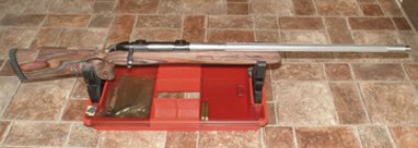

Richards Microfit stock inletting for Browning Eurobolt,just to let you know I have had my Euro Bolt re barreled with a border Barrel and fitted to a Richards Tactical Laminate stock inletted for a A Bolt Long Action 270. fits fine requires a little work worth the effort, just fitted Pillars and Bedded will look great once shaped and finished with oil.
Euro Bolt Glasgow.Scotland. work in progress.

Nice to know that there is some one with a euro bolt out there,Browning rifles are just getting popular over here, I had a 20" Barrel on mine but had a custom 28.1/2" Police special
stainless steel Cut barrel Fluted with a 1/9 twist for 140grn heads this is a work in progress and should be finished in a couple of weeks,I will post a pic then. euro bolt

Excellent looking job, thanks for taking the time. Im definitely going to get my baby sorted shortly.
