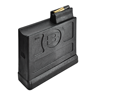

I would suggest a Bergara B-14 as it is a Remington 700 footprint and uses full size magazines as well. SK Standard Plus is widely used for it's accuracy and price point.
