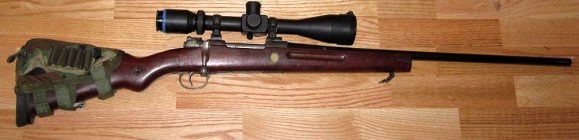

I bought a $35 take off Rem700 7mmRemMag barrel off Ebay, when they sold them.
I was building an expensive 7mmRemMag on a VZ24 action, so I was going to put the Rem barrel on a 1908 Brazilian Mauser at the same time to get tuned up with my new PM1236 lathe.
I dialed in the old Rem barrel on the 4 jaw with respect to the chamber.
I dialed in the spider so the barrel would tip in the 4 jaw gimbal and the chamber would dial in at more than one depth.
I cut off the Rem threads with a parting tool.
I cut Mauser threads.
I put the 7mmRemMag reamer in the breech without de burring the hole.
The reamer started wobbling.
It wobbled for the whole ~ .625" + deep cut until the chamber headpaced with the 1908 receiver.
I measured the run out of the newly cut chamber with respect to the lathe; 0.0050", which is about how much the reamer had been wobbling.
I put the action in and old cut down VZ24 stock and bedded it.
I went to the range and sighted in at 50 yards with 162 gr SST 2950 fps.
I shot one 3 shot group at 100 yards: 0.75"
Had that chamber measured 0.0000" run out, I would have not expected that group.
This calls into question the relationship between dialing in a barrel and group size.
We know there is a mathematical relationship between eccentric ammo and group size, and that has been verified.
But the eccentricity of chambers does not have that same relationship, because of constant rotational orientation.
I do not expect old barrel dialing in habits to change based on facts.
