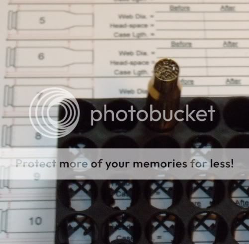

I did not mean un-even charges.... I wrote and meant un-even POURED charges.
As to say the manor that you pour them into the funnel can cause different height powder columns, which can greatly effect seating.
Example:
Below is a charge poured fast over the funnel.
Below it is the same charge poured slow and onto the side of the funnel.
Donovan
Never thought about this. I do tend to just dump the powder fast. I will try. Thanks!
