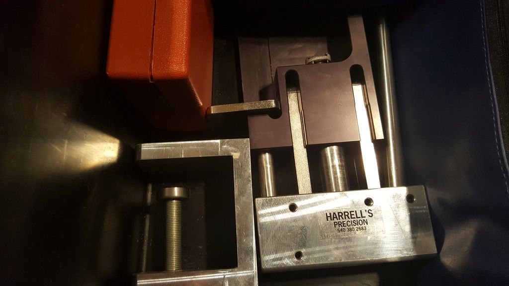

See attached photos for mine. It is an MTM utility dry box.
In it i have a harvey deprimer. All the small tools for reloading. Sinclair priming tool, harrell combo press, harrell BR powder measure and a gempro digital scale. Bunch of stuff i have accumulated while reloading. Have another MTM box i keep bottles of powder for the power measure and primers.
That helps, thanks.
