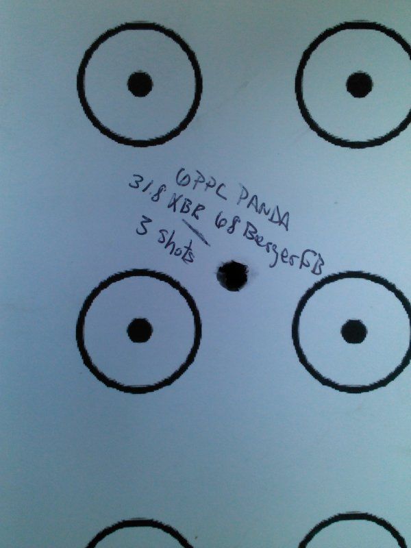

I have been using it in my 6PPC with 68fb bullets and 205m's and Lapua brass. I am running more than 2g over the max load data. Actually here is what I found that made me start going over max listed data to get it to shoot better....as always proceed with caution and work up slowly if you do venture over the manufactures max data.

Here were the first 3 shots I took at this load. I stopped at 3 because I couldn't believe they were going in that tight and had to go have a look....I actually thought the other shots might have not made it to the target.
Shane

Great shooting with Bergers. I have not been able get that good of groups with them.
31.8 seems like quite a compressed load. How did the primers look.

My primers looked ok to me. I did try that load in a Sako case and lost some primers,so I would work up. It just seemed like the hotter I ran it the better it grouped,it also worked out like that in my Ruger M77 6PPC. I could have missed a load on the lower end that would work out but I just stuck to this one.
