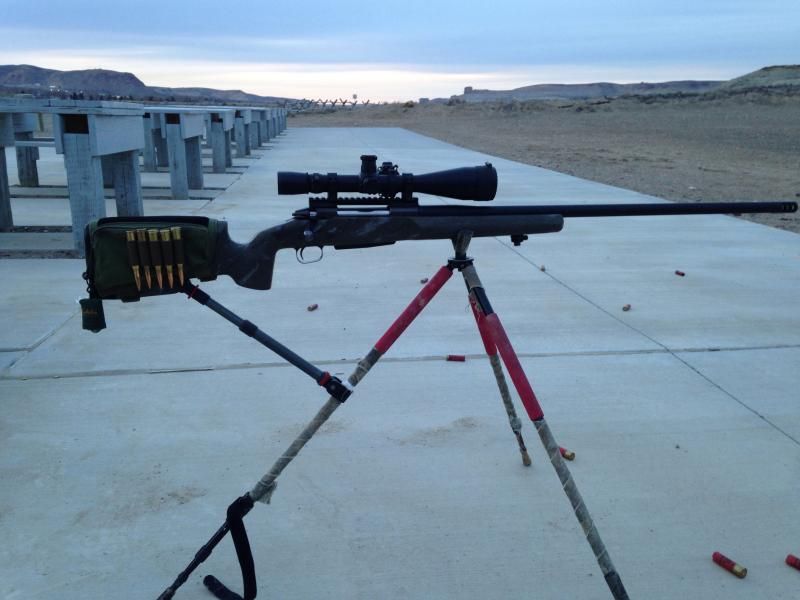

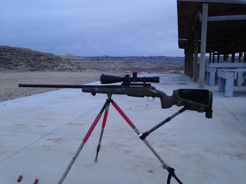

This is what has worked best for me of all of the things I've tried so far:
Bog Pod tripod with a Stoney Point tag-along-arm, a little bit of Teflon tape around the Bog Pod arm to increase the diameter to fit the tag-along-arm.
I use this system for pretty much everything long-range in the field where a bipod won't work. Great for coyote hunting as it free's up both hands to call with, etc. There is some side-to-side wobble that I've learned to minimize through technique and practice. This works great on rifle stocks with a butt-hook as the tag along arm 'locks' into the butt-hook perfectly.

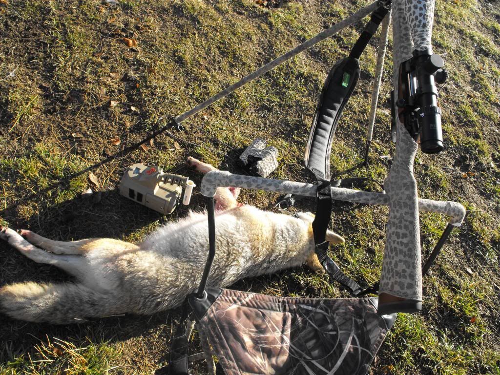

What I do is hold and tension the rifle sling in the left hand that is also gripping the left tripod leg, pulling enough to move the crosshairs to the left of the POA (works best with a sling on the left side of the forearm). Then I brace my right elbow on my knee using something like this:
... and push gently, applying enough 'counter-tension' to bring the crosshairs back on target.
I've taken coyotes out to 749 yards and elk to 889 yards with this setup, including taking an elk at 750 yards last weekend. Also, my POI matches my bench POI with this setup.
