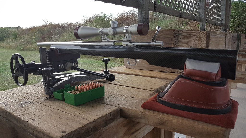

I'm not really a new shooter anymore, I've been at it several years now, but am struggling to graduate from the bottom of the lists at matches, to at least the upper half. I've never placed in even a local club match. I usually agg around 0.4-0.5", I've been slowly upgrading my equipment as my budget permits, Have a fairly nice rifle and rest now, good dies and reloading equipment, good set of flags.
Many other shooters have tried to show me how they tune their loads to the conditions, but haven't been able to really get a handle on that yet, was reading in the PPC primer on this website, how Jim Borden says that can kill you, and that he pre-loads all of his ammo before a match, and aggs in the teens. I would love to be able to do that. In practice I usually shoot at 200yd, and try to keep all my groups under an inch, about half are 0.5" or better, but what usually kills my agg, is that occasional 1.5" group. I've been shooting mostly Barts Ultra's and Cheeks 68gr FB, haven't had any luck with boat-tails. I have tried H-322, Benchmark, N-133, and LT-32. Had kind of settled on about 29.3 - 30.2gr N-133, but when it became hard to get, switched over to around 28.7-29.3gr LT-32. Just feel like I'm stuck, nothing I've tried lately has seemed to make a significant improvement, and am not sure what to try next.
