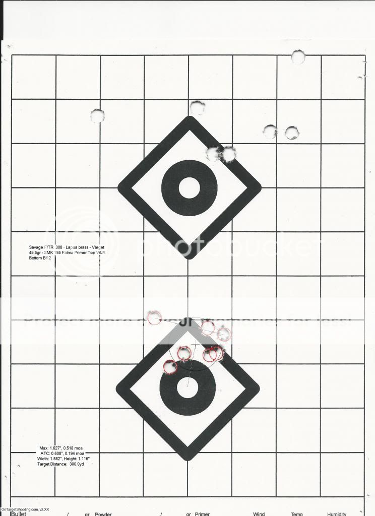

That your choice of Primers makes a difference check out these 2 targets. The load is identical except for the primer. Top target is with Winchester LR and the bottom I used CCI BR2s fired at 300 yds
I'm not sure I follow the point you're trying to make. Did you work both these loads up independently? Or did you work one up and then just change the primers for the second load? Or what?
You've got me confused.

Your results surely do show the difference in primers, but what JCS is referring to is that just shooting the exact same load with a different primer is not a true test of the primers. You should work up a load using each primer and see then if there is a glaring difference on the target.
The load was worked up using BR2s and is my go to load for this rifle. But I'm running low and wanted to see if I could use WLRs as a replacement. So I built 10 of each to compare. Firing them in round robin fashion. The range master called a cease fire after only 7 of the 10 rnds were fired but it's enough to let me know that a direct swap isn't going to work.
You may have to change amount of powder to make the other shoot. I would chronograph the two and see if there is a difference. Matt
Yeah. I'm not new at this. I knew there was going to be a difference. I just didn't expect this much. I mostly posted this for any folks new to reloading and not aware of the difference changing from 1 primer to another can make

Was the barrel cleaned between test or were they fired one type after another, could be that fouling has some effect ::)

If u would have worked the load up up with the win primers then change to the cci's, you would have seen the same thing in reverse.

Not necessarily.
You don't know what charge of the powder used would have produced accuracy with the Winchester primer, or if the Win primer would have shot decent at all with the same powder. When the charge amount or powder type changes, you would have to re-test this scenario and there would be no way to guess the results.
Using a different amount or type of powder to charge the case may find a node that accepts both primers and maintains good accuracy. But you just don't know til you try it.
