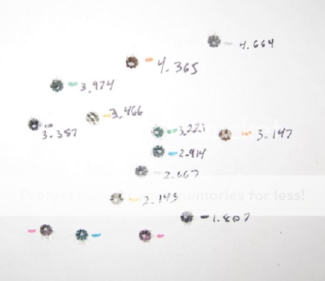

White poster board and sharpies have worked great for me. As mentioned, red, green, and blue work great. Black and silver also works really well.
Here's a photo I took a few years ago:
Jimbo - where do you apply the sharpie color on the surface of the bullet - from the color on the target holes, looks like maybe from the tip all the way to through the ogive?
Just the tip. If you look at a poly tip bullet like the vmax or nosler bt.. the color goes a little bit past the poly part.
When I get home with the target, I push in/up from behind each hole.. in essence closing the holes. That makes it very easy to see the color that was transferred to the target. With out "closing" the holes its much harder to see the color.
