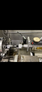

Arron I’ve been using a pusher like Dave or Bryant uses. No problem pre boring and starting the reamer. I straight bore most of the chamber out then on the back end bore somewhere around .200 deep or more depending on the chamber to get the reamer started in.
Most anything can be used as a pusher. Make your own. It can be held in a drill chuck or take a drill chuck and put a flat washer between your reamer holder and the chuck. Then crack it open slightly to give the reamer shank some clearance. Take a MT drill chuck adapter and drill it out holding the drill in the lathe chuck. The options are endless. On the Haas I'm using a MT adapter in the little tailstock I mount on the tool post.
The goal is let the reamer float/self center with as little friction as possible. With a concentric hole the reamer just falls inline. And don't worry about pushing the reamer off center. It won't happen. None of the forces involved are the very heavy.
This is an old photo. I tried mixing Moly-D with oil. Quickly abandoned that. Not good for your lungs. reaming chamber.JPG
