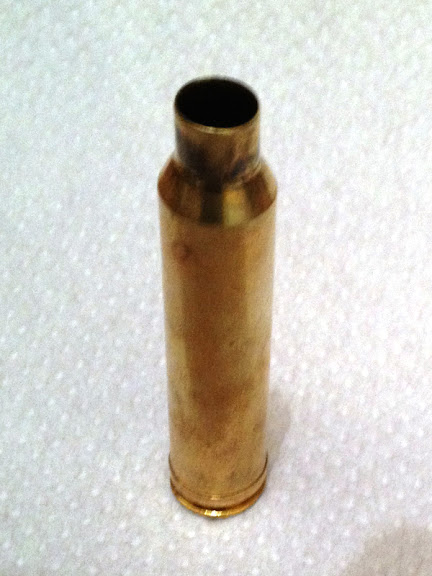

here is a case that's already been cleaned in the ultrasonic for 16 minutes, wiped dry and primer pocket's been cleaned.

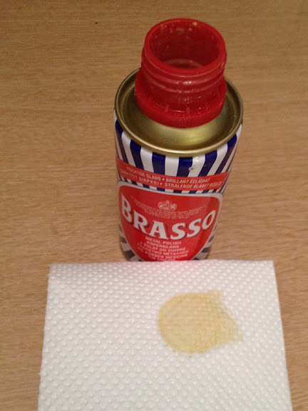

this is the amount of Brasso used, quick turn of the can and excess liquid scraped back in to the can.
this is the dirt that came from that one case...
and here it is compared to another ultrasonic cleaned case..
in 16 minutes I could probably wipe down 40-50 cases with Brasso, kinda boring but the result is amazing..

Dansig---just be aware that Brasso has stuff in it that will harm brass cases over time..
