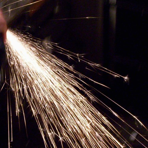

If you put a piece of steel against a grinding wheel, you can get a general idea of it's chemistry by looking at the sparks generated. Carbon, manganese and other elements will each generate their own color/pattern.
