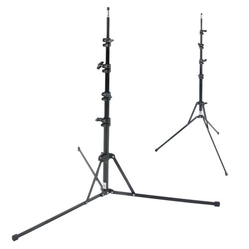

I use photographer's light stands and modify them so the legs can spread nearly flat on the ground. with the extra width of the legs being able to spread out I never had them blow over even in 50 mph gust.
my wind indicators are another story. since they can't pivot in the wind with those I use 5-lb. barbell weights from Walmart with cheap bungee cords and hook them on the legs.
