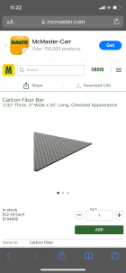

I figure I could make a heat shield. Poster board?,
It's like foam board, really light stuff. Do you Velcro the shield to barrel?

Both of these I can power by battery pack.
I'm going to try and use one tomorrow morning.
Would the small one work, or does mirage take a wider air channel to get out of the way?
I'm sure I'll find out tomorrow'.
