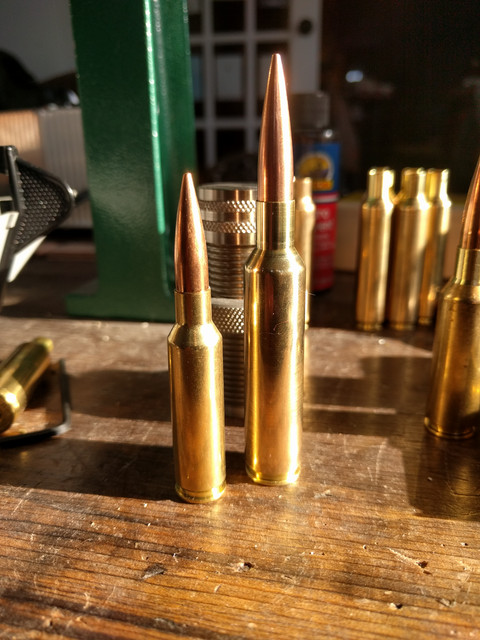

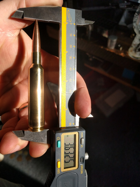

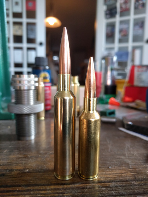

The pictures show the coal, comparison with Federal 6.5 Creedmoor loaded with a 130gr AR OTM, and comparison with a 7SAUM loaded with a 175 Berger (excuse the ugly RP brass).
