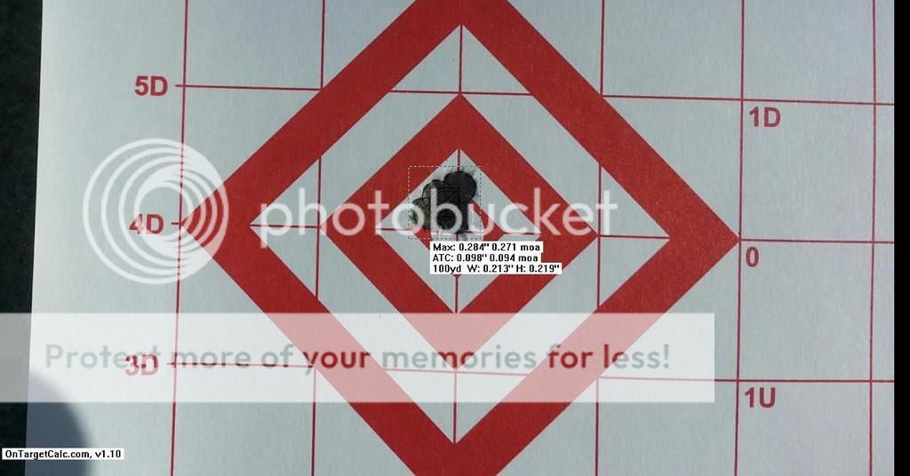

Also here is a pic showing the extractor swipes - they get more pronounced as the charge weight increased, but, like i said, extraction didnt become an issue until 26.8.

Your brass doesn't look bad at all. Its probably just because that brass is slamming back against the bolt as it grows. With my turbo 40 i partally sized the neck leaving a donut that acted as a false shoulder for fireforming. That is why i suggested seating some 108's long and jaming them in the lands to hold that case head up against the bolt until you get the.brass fireformed. Don't be afraid.to jam them. They just have to be single loaded. Some of.my best groups were shot with 105 vld's jammed.about..020.
