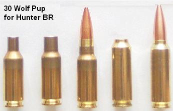

Ware Wolfpup:
"Our Wolf Pup cases,.080″-.085″ neck lengths) show similar loaded round runout figures to our other .30 caliber cases with .320″ and .250″ neck lengths. We set the throat to position the base of the bullet well below the neck-shoulder junction. Obviously, the throat is quite a bit longer on this setup than the freebore length that we’ve been running with our more traditional neck lengths...that is, freebore lengths in the .000″ to .035″ range for bullets based on the 1.00″ long jackets and weights in the 118-125 range. We worried about bullet misalignment in that short neck, but jamming the bullets into the lands seems to take care of that–provided the chamber has as little runout as possible, is well-centered to the bore and the cases are sized aggressively enough to allow a bit of ‘wiggle room’ in the chamber."
