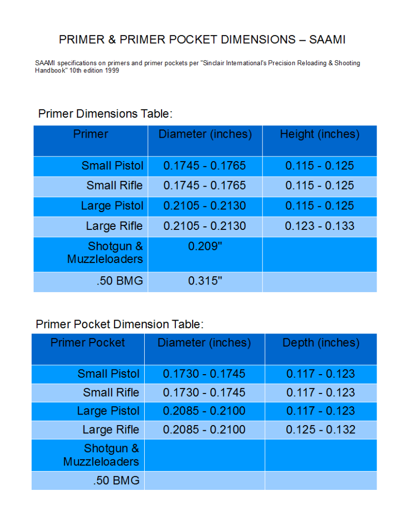

Based on tool and gage design practice you would use a gage pin .0002" smaller than the maximum permitted diameter.
A NO GO gage pin for a large rifle or pistol primer pocket would be .2098 +.0000-.0002.
Depending on the actual diameter of the gage pin this diameter will reject good parts between .2098 and .210 diameter but it will not accept bad parts at .2101. If you want to reject fewer good parts your gage pin tolerance should be something like .2098 +.0000-.000050 (that is minus 50 millionths). Most people do not have the touch for 50 millionths so you either toss a few good parts or buy an air gage capable of gaging in the millionths.
The gage pin should reject any primer pocket that is oversize including those that are out of round or egg shaped.
To reject an out of round primer pocket the pin should be ground to a Double D shape. This will permit inserting the gage pin at 2 or 3 different orientations so you can detect an out of round primer pocket. Just remember that if the primer pockets is oversize anywhere is it out of tolerance. This includes even a slightly oval primer pocket that is oversize only on the long axis.
If you reject cases based on seating force only you should check your primer diameters too.
Small or under size primers may cause you to toss brass that is still in tolerance.
Three legged primer anvils will cause primers to be shaped like Wankel rotors which cannot be easily measured with a conventional micrometer. These tri-oval shapes always have a low spot opposite a high spot.
