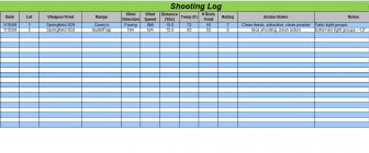

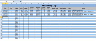

I keep a lot on my spreadsheet workbook to not only include different guns, barrel and tabs containing other information for quick reference that I've collected. I'll record data when firing then transfer it it all to the spreadsheet and with the spreadsheet accumulation over time I can sort get information like I want.
Here's a sample of my spreadsheet that you or anyone else may use if you find it useful and may modify to suit your own needs:

A few years back I determined to get my entire load history moved to an electronic format. I built a spreadsheet very similar to what Straightshooter 1 posted. Last winter I finally got all my old loads moved over. It's world's better than my old paper log! Instead of having just a single, very small "Notes" field, for instance... I can include as many details about a load that I want, and can embed things like QuickLoad prints, target prints, ChronoPlotter charts, close-up jpegs of my micrometer seater settings, etc. If I'm running a ladder I'll use a separate fill color on the charge weight, predicted velocity, and actual velocity columns so that your eye sees the entire ladder at a glance.
