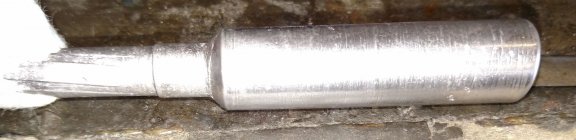

Lynn suggests:
"...make a Cerrosafe cast of his chamber and measure from the lead to the start of the lands using a loupe and a steel ruler or calipers. Here is a picture of how I do it.
It will be within 0.003 and good enough for most purposes."
