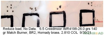

The 6.5 CM has the better trigger & is a 1" to 1 1/2" @100 yard gun.
