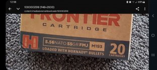

I bought a box of the cheap factory frontier 55g fmj to get my AR15 223 wylde with a 20" krieger 7.7 twist on paper with the new 5-25x strike eagle scope I just put on. Box says 3240fps, so you can imagine my thoughts when I was getting 3475-3500fps. Popped 1 primer out of 10 rounds, and had a severe gas leak on another. I quit shooting after the 10th round and the popped primer. Anybody else ever ran into this issue? Velocity was measured with the Garmin. I also tried another factory load, federal 53g vmax clocked in at 3381fps average for 10 rounds, box says 3400fps. Brass all looked good on those, nothing over pressure. Then I followed up with my handloads of 25.6g Benchmark with a 53g vmax. Velocity was 3310 for 10 rounds. Nothing shot great, matter of fact the factory federal 53g vmax shot the best at 1.25" for 5 rounds at 100 yards. The frontier 55g fmjs were like 2.5" and my 53g vmax/Benchmark were like 2"

I think I'll call them and give them the lot #. I did see some things about kaboom with frontier 55g ammo few years back. I guess you can't expect much from $8 box of ammo...Not going to worry about $4 and 10 rounds.
I'm the OP...It's not a chamber issue. Does anyone else think firing 5.56 in a 223 Wylde chamber is the issue? Seems to me like it's an ammo issue. When factory loads are running 200-250fps faster than what they should, that's the problem. And after a bit of research on this ammo, it's had A LOT of recalls for being over pressure, and destroying rifles in the past.

I'm not shooting anymore of it, that's for sure. Definitely won't be buying anymore of it either. I just bought a cheap box to get it on paper before I used my handloads to get it dialed in.
I tried calling Hornady, but looks like they're closed on the weekends. Have to give them a call Monday and let them know about this lot. I'm not going to worry about being reimbursed for 10 shells worth $4. Not worth my time, hassle, and definitely not my rifle or my life...But it still needs to be brought to their attention because something really bad still could've happened with the 10 rounds I did shoot. Lucky all that happened was 1 popped primer and 1 gas leak.

Definitely get a hold of Hornady and don’t shoot any more of those! First thing they are going to ask is how many rounds are on the rifle and have you confirmed with a bore scope that there is no carbon build up in the throat or lead in the barrel. According to their podcast, most if not all over pressure issues end up being rifle issues and not the ammo. I’m sure they’ll want a sample from you though to test.

Has around 600-700 rounds through it. But it's been cleaned several times. No carbon ring. If it had a carbon ring, the other 2 ammo I shot would have been sky high also, not just the Frontier, which seems to be the problematic type....
