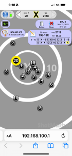

Aside from outright blowups, which you simply must take steps to avoid IMO, A-Tips can shoot. Monday, I shot this group at 200 with a 300 WM / 250. The square’s an inch, so center to center is probably .33 moa. This has a threatening enough potential to shoot well at 1,000, crossing the target about 1,900 average over the whole day.
Same bullet at 600 can look like this, the good and the 9, with a big win mag. I emphasize win mag because it’s not really intended to shoot tiny up close. It’s a lot of powder and an evened out long range wind bucking group, was more the idea behind it.
