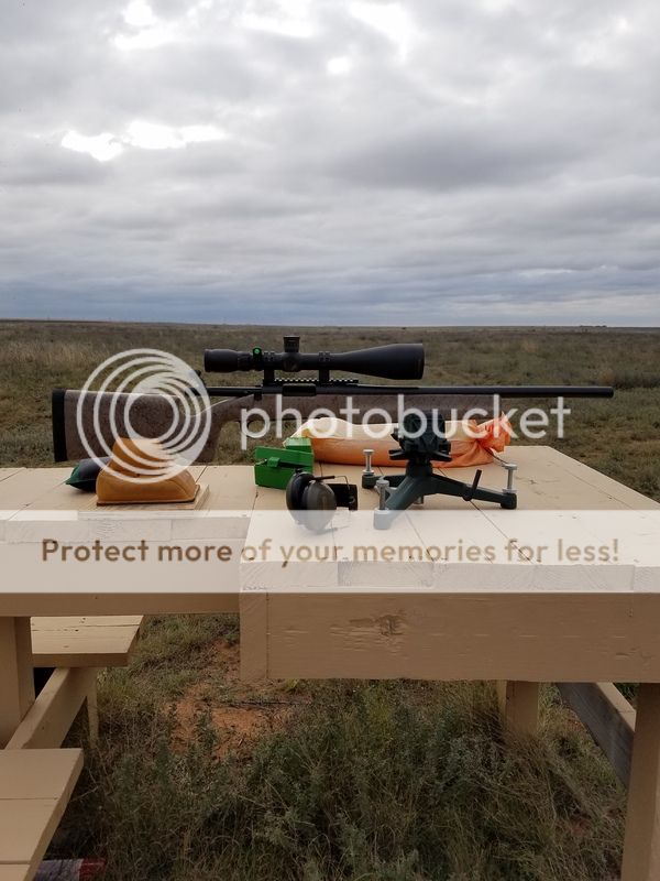

Quick update,made it out to my range,very,very,promising.
A little wind blowing in from 1 oclock,to 7 oclock,around 8 mph.
If I hadn't pulled a shot on a couple of groups each,would have been very good groups.i was shooting 5 shot groups.
Looks like there gonna be just as accurate as the 68 and 69.
I'll post pictures later tonight
powder is rl15,cci br4,lc10 brass
