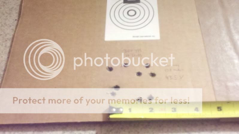

200 yard load test
My rifle shoots them pretty well, but be very careful if you try to use that load data on the target, it's pretty hot. (don't you hate that one flyer)
That is a nice group! Well understood on working up. Most of these loads are over max or very close. Hornadys manual seems to be a little more conservative than others.

Was about ready to give up on this bullet. Tried loads in .1grain increments from 44 to 44.8. Then dropped to 43.5 for my last ten bullets.
300 yards, about 2.5" ten shot group. Not quite as tight as I would like but may play with depth some. Interesting thing is there is two vertical strings there. Looked at the velocity and sure enough, five shots within 10 fps on the bottom and on the high side if the ES there were five within 10fps as well.
ES 33, SD 11 avg velocity 2762.
