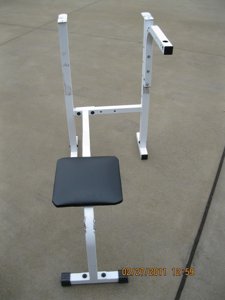

I found myself needing a shooting bench for the deck and in a couple of hours I was set.
I bought some weights off Craigslist awhile back and the deal just happened to have a weight bench in it that I didn't need.
I stripped everything off the bench that I didn't need. I cut the leg press mounts off and grinded them smooth.
I moved the seat support bar to the left.
The flanges that hold the bar on the uprights need to be altered. I removed the rear flanges and flattened out the front flanges. Then I grinded everything smooth. And then mounted the leg press bar to the back of the right upright.

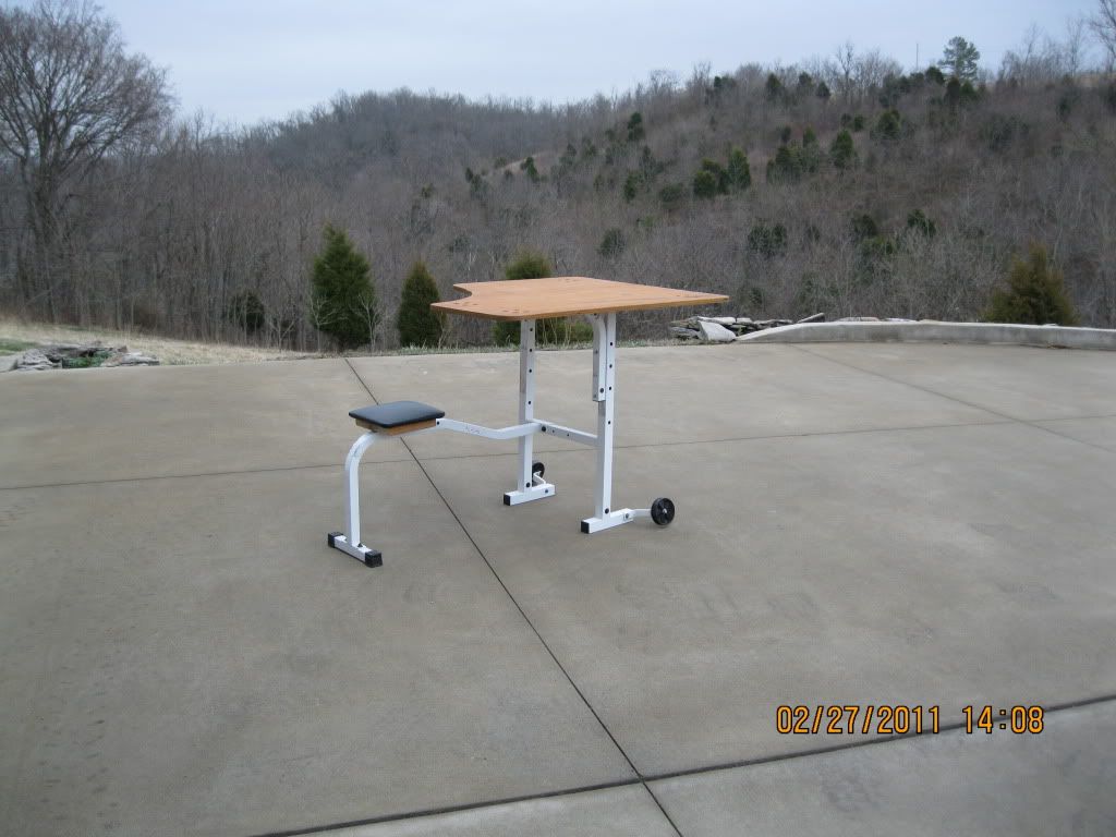

I needed a top and I stole one from an existing rickety bench I made years ago. I countersunk the mounting bolts into the top using the front flanges and leg press bar as mounting brackets.
The seat was a little low and I thought a piece of 2X10 would support the seat better anyway.

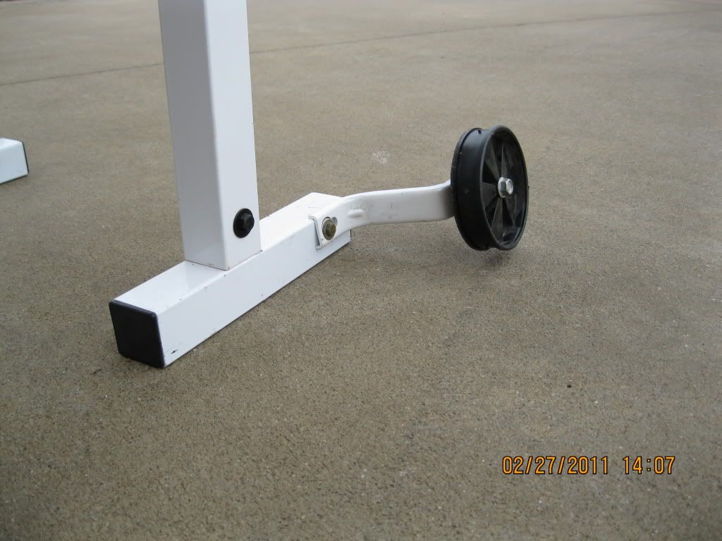

And then I mounted some training wheels to the front.
Another view of the wheels. Lift the bench right behind the seat and you can move this with one finger.
Completed bench.
And now overlooking 15+ acres of brushy hillside.
Completed bench.
