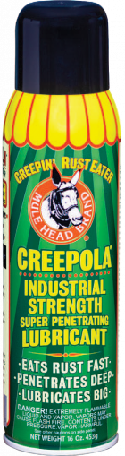

The BEST thing I ever tried as a farmer working on old stuff on a coastal island was this. I used it when I was at the last step before a torch or grinder and it worked. So good that the parts store had to hide it in the back so their regular customers could have some available. If you ever see it, buy a can. It out performed every other product available to me.
