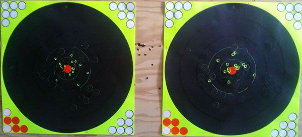

I use 18" Shoot-N-C targets stapled to a 2'x4'x3/8" plywood sheet to shoot practice rounds for F-TR. I attach the board/targets to two of those 4' green steel garden stakes using 4 small hand clamps. Before stapling the targets onto the board, I black out all the lines/numbers with a phat black Sharpie, leaving only the red aiming dot in the center. I do this because holes on the lines or numbers can sometimes be hard to see. I have no trouble seeing .223/.308 holes in the targets at 600 yd unless the mirage is absolutely ferocious. Below is a picture of two targets shot at 600 yd with .223 (l) and .308 (r). After I get home I use a compass to scratch in the 6" and 3" 10- and X-rings so I can "score" the target. Using the pastors, I typically get 4-5 uses from one target.
