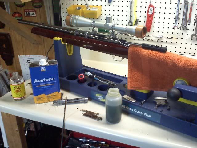

I thought some of you might find this little tip helpful to get the most out of your brass cleaning brushes. After i use a brass or bronze brush i drop the used brush in a plastic bottle of acetone. The acetone strips the copper dissolving agents from the brush thus stopping the eroding effect the solvent has to this material. I used to spray my brushes with carb cleaner but we all know what a mess that is, not to mention the smell. I store my used brushes in the bottle with the acetone and when i go to retrieve them for there next use they are clean and ready for work. I just wanted to share this with you fellas. I know some guys use a brass brush one time and then they pitch them. i cant afford to do this and now there is no need to. Hope this helps. Lee

This works quite well for me, i can assure you that!! The dirt and grit settles tot he bottom of the bottle and when i pull a brush from the acetone it is clean and ready for use. Works quite well actually. The plastic bottle is a chemical safe bottle of course. That should go without even saying! Lee
