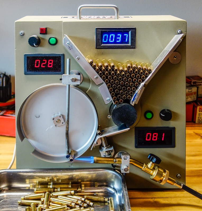

Before you buy a ready-made unit, consider building one. The "Skip" design annealer has been built by many folks, some for well under a hundred bucks. Mine cost a bit more than that, but it used some nice store-bought hubs and includes a round counter and a proximity switch on the feed ramp so that there is never any sync problems. Complete details, including parts lists and component sources, are available on another forum.
Mine is easy to use. Just load the hopper with a hundred rounds and watch it run. It's adjustable for any reasonable annealing time in small increments. Plus, I can change from .223 to 6mm BR in 10 seconds by simply adding a little shim.
_DSC3404
+1 for the homemade option
But don't be scared by the beautiful example pictured above. Unless u are annealing large quantities of brass you may find hand feeding acceptable. building one like pictured above WithOut the case selector should only take a couple hours to build.
I hand feed mine (skip copy) with a cook time of 4 to 6 seconds which means a box of 50 takes about 6-7minutes counting the dead time on the pan. Not a huge waste of time. I wish I could chamfer debur or turn necks that fast.
All you need to get started is the spinning pie pan and a ramp for them to drop into the pan. Then go all the way like mozellas example when you need more volume.
