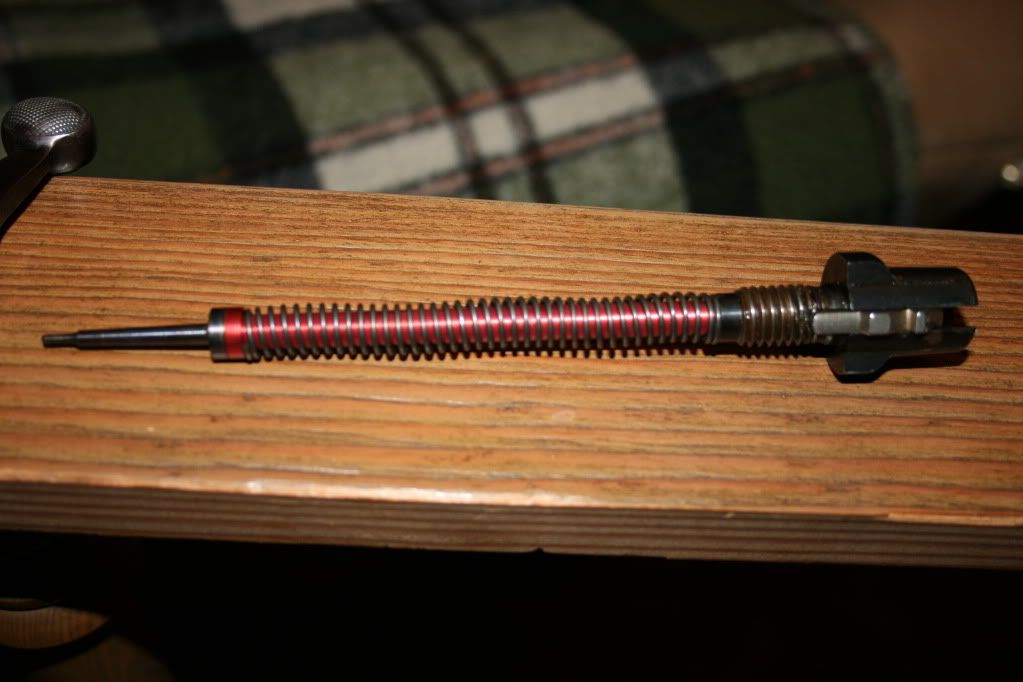

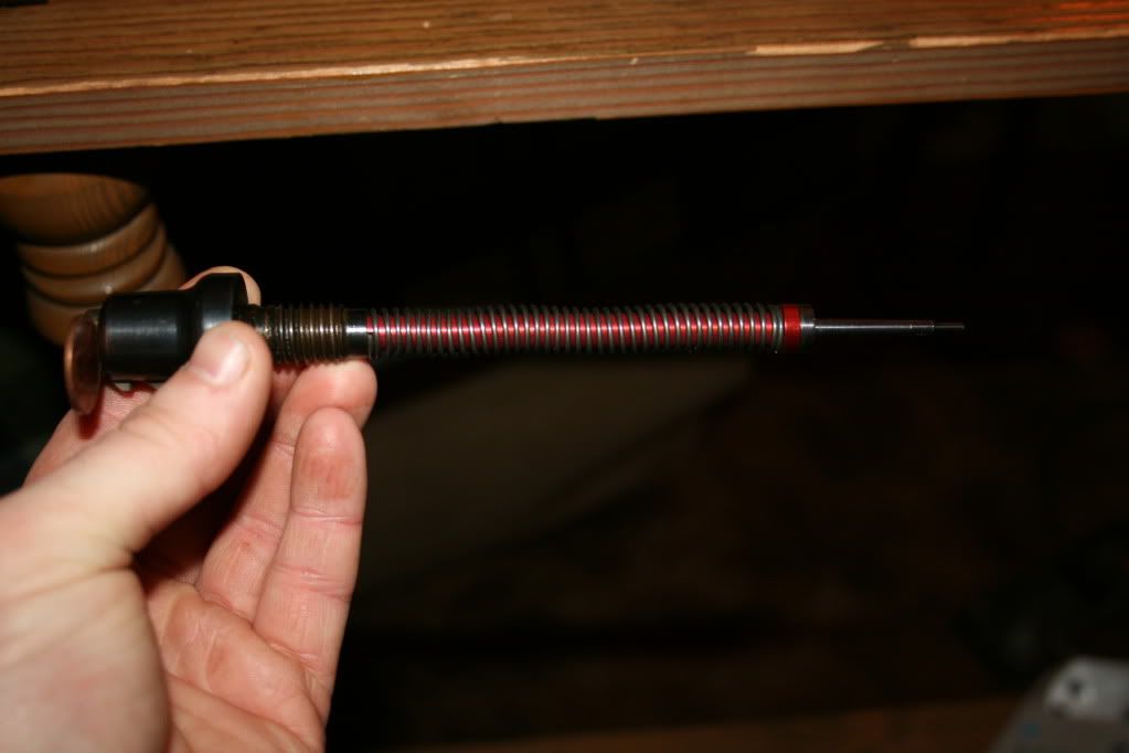

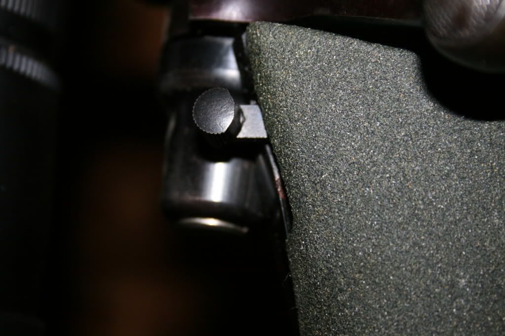

I changed out the firing pin and firing pin spring during this build. I installed a Speedlock. I noticed when I took the original remington spring out the spring was alot more coiled and bunched up. My other Rem 700 is at the smiths to so I don't have a referrence for this but my cocking peice doesn't seem to be sticking out very far pass my bolt shroud when the gun is cocked. Atleast that's compare to my model 70..Does this look right??
Here is some pics of the firing pin. Notice in 2nd pic how little spring coil there is and this is with the cocking peice pulled back alot futher than it's suppose to be for opperations. I'm wondering if it's a SA spring.

For firing forming i use a false shoulder to keep the case head up against the bolt head. This can be done with a expander thats one size over your caliber then start you neck die high and go down untill the round chambers tightly. Have you check to see if the cocking piece is dragging on the side of the trigger group or anywhere on the back of the action and bolt? Did you put it together dry of use a lubricant of some type? It looks like your protrusion is just fine but something is stopping it from hitting full force once in a while.
