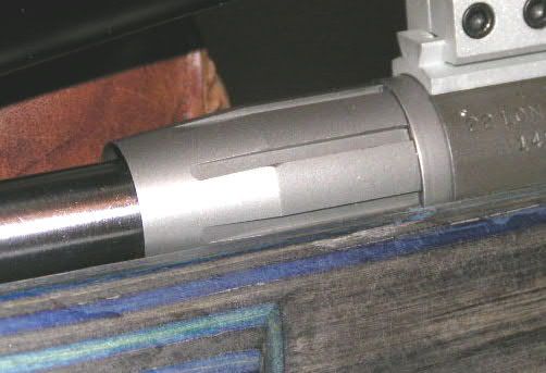

next time you have a bbl spun up for the Savage, forget the nut and have the bbl shouldered like a conventional rifle and there wil be no more problem with incorrect headspace. That nut is about the only thing that Savage made a mistake in doing. I really respect the rest of their work.

I have to take the complete opposite view on this one. I completely respect them for using the nut. If you're going to loose the barrel nut, you might as well buy a remchester.
That nut lets me order a custom pre-chambered barrel of my choice and install to what I want for headspace myself. It saves me from adding several hundred dollars to the cost of setting my rifles up as I don't have to pay for all that extra time and labor.
It really isn't hard if one pays a modicum of attention. One simply has to have a little spin on the ball to make it work right I guess. ;)
One other thing about setting the headspace. If you set it on the "snug" side, your brass won't grow like it would on a "loose" SAMMI spec chamber. After 3 or 4 firings you might have to bump the shoulder back a taste. Sure beats "full length resizing" every time.

I don't agree with you. I use the Pacnor nut on my Remingtons. I also slot the front of the rec so I can use a Savage spec recoil lug and have converted one of my Rem bolts to use Savage bolt heads. The only place Savage screwed up was the trigger design. I gotta have my Jewels :-)
