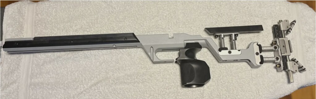

Can anyone tell me what this style of Anschutz aluminum stock is called? I would really like to find one for my Anschutz 2013, but I'm not sure what it is called so I don't know how to search for it.

I believe the model designation for the square action version is a 2313 (round action was the 2213).
I suspect you will have a challenge finding one: they don't come up for sale often at all, and most of the ones I've seen are the 2213 (round action model). You might try a WTB ad here or over on TargetTalk.org, but there's a couple folks over there who've been looking for over 6 months with no bites.
Were it me, I'd have a low threshold to find an alternative. Knowing what particular feature(s) you like about the Anschutz 2313 might help folks here steer you towards something that's a bit easier to acquire.
Good luck!
As above, that's a 2313. Anschutz made it from 1999 to about 2008, when they replaced it with the machined 2018 Precise.
The buttplate isn't a factory-fit though. Although these are replaceable, the standard option was the 4765. The rifle pictured sports a Tec-Hro.
Just a FWIW comment.....
More than a few of these stocks developed cracks around the action / grip areas. They were manufactured using a compressed / sintered powdered metal, not a billet as the current models are.
Just inspect before buying,
