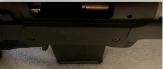

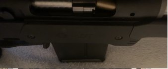

Here are a couple of pictures showing this older brass coming out. It starts out on a steep angle (and I now think that’s probably where the neck/shoulder is getting nicked) and then falls off as the bolt comes back.

Slapping the neck against the side of receiver is not what you want to do...lighten up the ejector spring until it ejects the case for your needs. -Al
I had @Grimstod work over the bolt of my Savage based 6BRA including bushing the firing pin and removing ejector and plugging the hole. It’s the best money that I‘ve spent on a Savage except maybe a shouldered Bartlein barrel.
Post #8 of this thread shows a simple mod for your ejector pin for 6BR cases. I successfully modded 2 Savages using this trick. Both now have a 99% ejection rate
