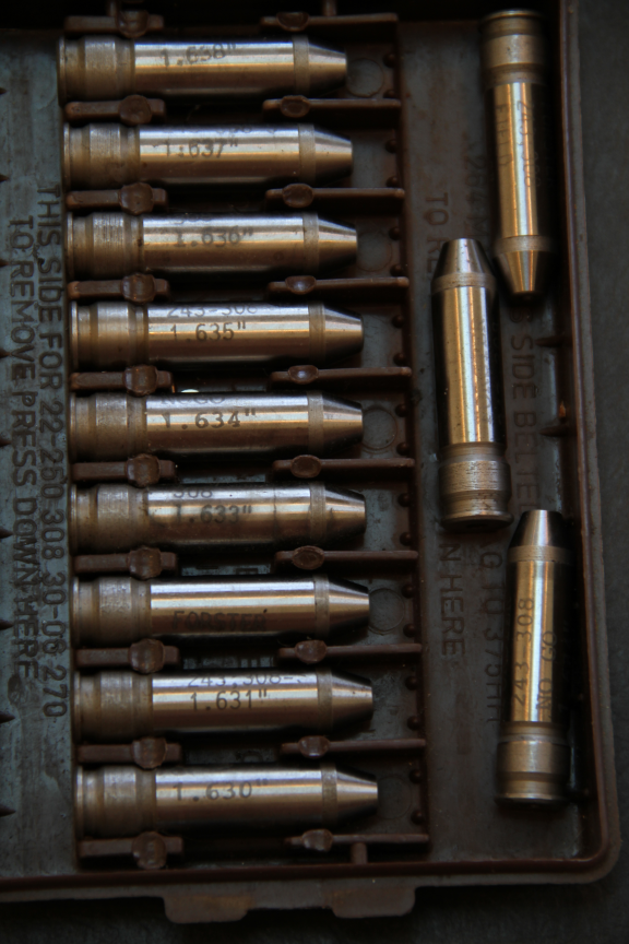

Now if you want to accurately measure a chamber headspace you can use a headspace gauge. While they are popular in sets of Go, NoGo and Field dimensions there are more elaborate sets as this one shown below. The set is a .308 Winchester set.
The basic set is 8 gauges starting with a 1.630 Go and working up in 0.001 increments to 1.638 Field. Another trick I have used is getting some quality stainless steel shim stock and paper punching small gircles out. A small dab of grease and they stick on the base of the actual gauges adding to them. You can accurately get your chamber headspace accurately down to 0.001".

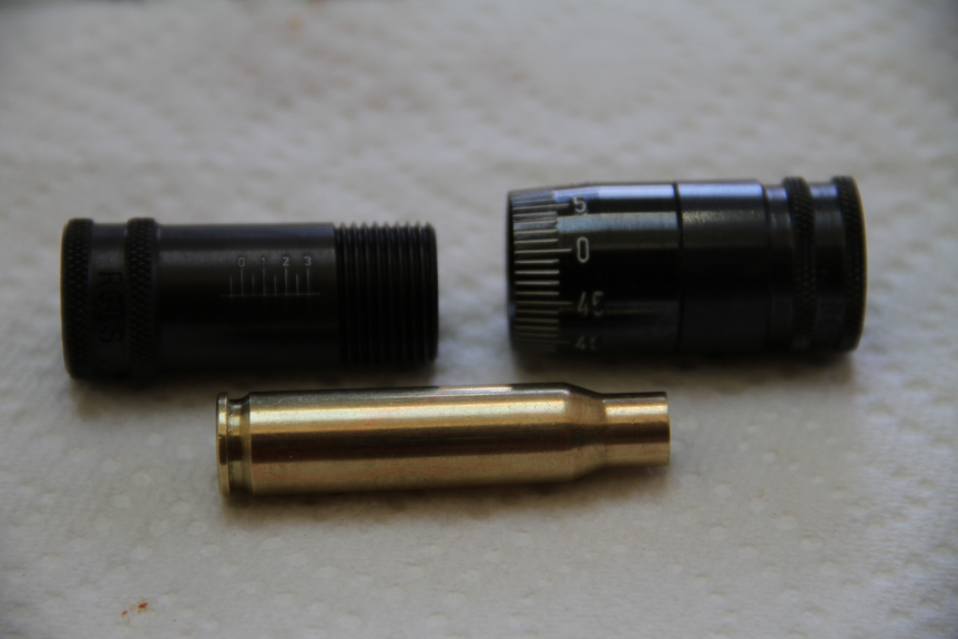

Now if you want to fire a case and say that case dimension is really close to my chamber then I like using the RCBS Precision Mic sets.
I can also check my RCBS gauges against a known headspace gauge.
