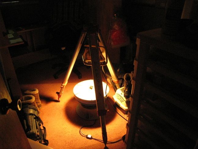

With hBN, we consider heat very necessary. We use heat in the form of a Halogen body shop lamp, and the projectiles will come out of the jars almost too hot to handle. Placement of the lamp is critical for the well-being of your tumbler. Too close and you'll soften the plastic

Sorry,........ I just realized I had not included a shot of our method of projectile impact coating and heating in the winter. 1.5 hours and then turn the containers 180 degrees for another 1.5hrs. Handles 200 .30 caliber projectiles. That one is the Dillon large commercial unit.
