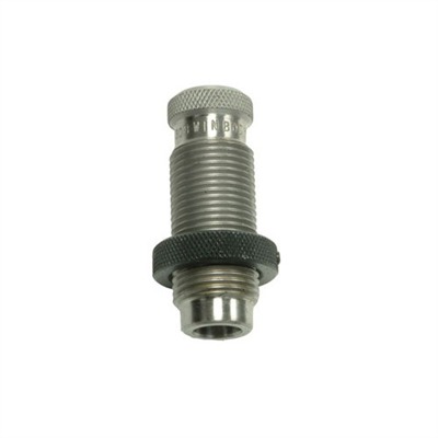

Now I have a .284 rig with the Redding comp die set. The part I am having a hard time with is the proper order and when to use the FL sizing with tapered Expander die, Neck bushing with ball expander die, and Body bump die. So below is what I think it should be and I am hoping someone can correct and set me straight. Also any tips or tricks would be greatly appreciated. Thank you in advance! 8)

Sounds like you have one FL die and one bushing neck-sizing die. If the bushing die is a type S FL sizer you should use that one only. Every Long Range Competitor I know and shoot with full-length sizes every time so as to push the shoulder back around .001" only. No expander ball since you can adjust your neck tension (.001" less than measured diameter for single loading, .003" for mag fed). If yours is a neck sizing die only I would think using the body die every third shot or so would keep you out of trouble. When the cartridge is hard to close the bolt upon, body size. Once you have formed your brass you should stop using the expander ball as it is a source concentricity error and negates the value in using bushings.

You ONLY need Two Dies. A Full Length Bushing Die such as the Redding Type S or a Harrell' AND a Seating Die, preferably with a micrometer top. An assortment of 4 Carbide Bushings that will apply .001" to .004" of neck tension and you're good to go. Always Full Length size or you're in for a series of headaches.
IF you're interested in accuracy then you'll want consistency, consistency, and consistency. Jumping back and forth between body sizing and neck sizing is not the pursuit of consistency.
Expander Balls and Bushings are contradictory/a dichotomy. IF the die comes with an expander ball, tapered or otherwise, [Harrell's never do] remove it and place it in a drawer.
With new brass, you can bump the shoulder back with a Full Length Bushing Die by leaving the Bushing out. Insert it when you're Full Length Sizing fired brass and want to apply neck tension as part of the fine tuning process that includes seating depth adjustments. No need for a another die. Keeping things simple is a longevity enhancer. :)

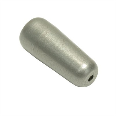

3. Sinclair case neck expander

3. Sinclair case neck expander <-- Are you expanding the neck after sizing the neck down?

You need to use the Full length bushing die. If it is not a full length bushing die sell that and the neck die and get a Type S Full length Bushing die. I would never neck size. You want to full length every time and bump the shoulder .002. I like an arbor press and a Wilson die to seat bullets so I can feel them go in. But the competition seater die is pretty good. Matt

step one is to neck up new palua 6.5-284 cases using a k&m expanderton tool
then i use the f/l/ bushing die to bump shoulders 1 1/2-2 thou and adjust the bushing up to partially resize the neck removing the chance of donuts
