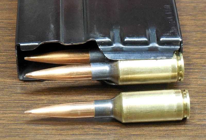

I have a 7mm WSSM. A friend volunteered to be my guinea pig to test out the idea a few years back. One requirement was that it feed from a short action magazine and it does.
1. a straight WSSM (30˚ shoulder) has less capactiy than a similarly-throated .284 Win chamber. The WTO 7mm SAW (effectively a 7-08AI) has less H2O capacity from the data I've read: 55.3gr vs 51.7gr
2. on a 28" 1:9 Bartlein 180 hybrids run about 2850fps. I believe the original barrel is still doing fine at about 1800 rounds.
3. He got about 30 reloads on his first 50 Winchester ".223" brass then the necks started cracking. Annealing frequently made a difference:
Yes, Winchester brass needs a decent amount of prep and sorting. Federal made some brass a while back. I have a pile of it and the production lot I have is better than Winchester I've handled. This was all worked up around the extended 2012 component shortages. Reamers were cheaper than brass so we went with what was available: oddball WSSM brass, and even that dried up.
The objective was mostly for shooting steel so I don't have paper targets and aggregated "serious" competition documentation. My friend has an F-Open rifle in 7mm WSM that is more suitable for 1K paper punching so he uses that instead of the WSSM. This is his somewhat neglected thread: http://forums.accuratereloading.com/eve/forums/a/tpc/f/6521043/m/7191005091
*edited to include case capacities*

I put together a 6.5wssm Imp. Turned necks, fitted chamber, custom BAT for the cartridge. Burnt through 2 barrels with an accurate barrel life of 1800rds(on 3rd barrel now), with the same 50 cases. That's like ~80 reload cycles, with zero body sizing (thanks to my chambers).
I know these Win reloading cases will last well beyond my lifetime, if not forever, as nothing has changed since fire formed.
The load is 47.4gr I4350 with either 140VLD or 139Laps. I chose a mid-node at 3020fps with 28" barrels. By QL it's right at SAAMI max, 65Kpsi.
This is as good as practical for 26cal.
I do not think it's a good capacity for best in 28cal bullets.

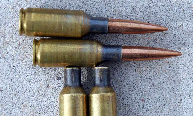

I've made it. Before I knew that other's had played with this long before I did, I remarked to my GS friend that I'd call it the 6.5 Diggler. WSSM brass is very thick, tough brass. 6.5WSSM on left, fireformed to 6.5WSSMAi (6.5 Diggler) on right. Both with a 150SMK loaded. Still makes me laugh looking at it. Drew
I will remark that my two 50-piece Win 25WSSM bags had several defective pieces that would have caused problems if fired, so I would sort this for safety sake if nothing else. Folds in the neck/shoulder junction area. wrote to Winchester about it. Crickets. I believe I still have two sealed bags of 223 WSSM if you would be interested. Drew
