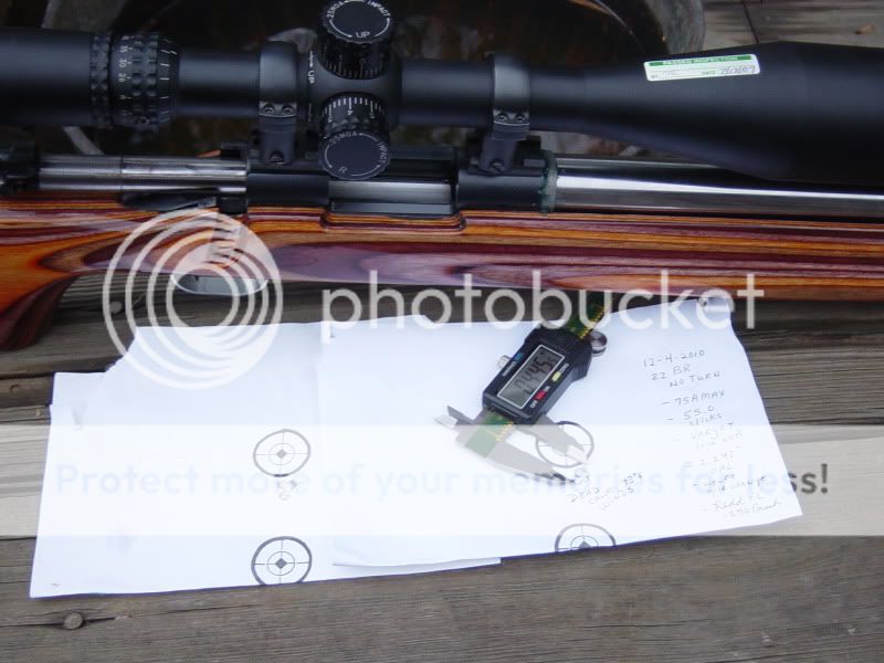

Rechambered to 22BR no turn after
the Ole Bosnian GunSmiht cut 2" off
the shank to get to good rifling=:eek:
Twisted on the tube and loaded a
few and=
This is my Mot Yelrom switch barrel
Remy 700=wearing its new 22BR motor=

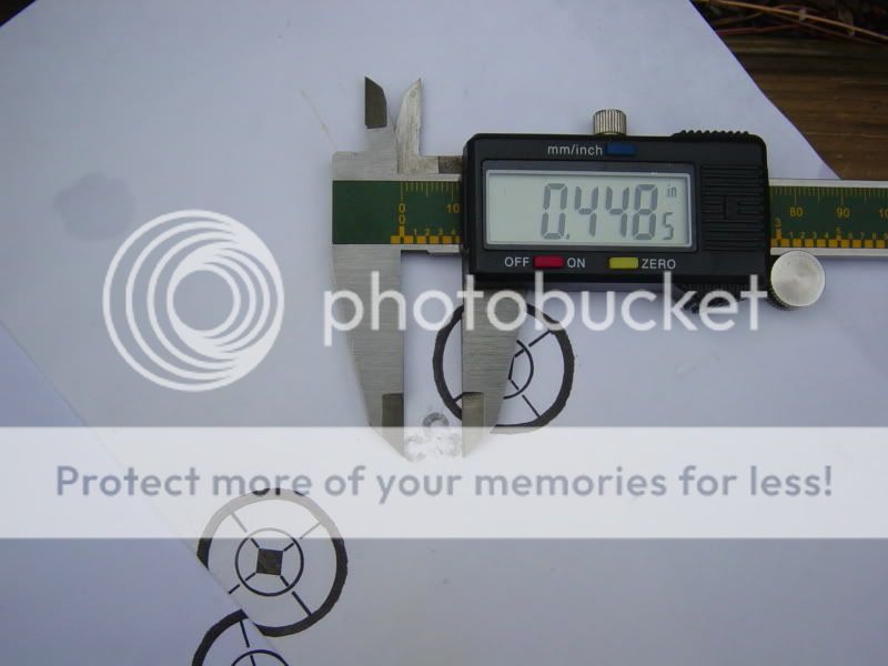

This was the first 5 shot Fireforming group=
.448"
- .224"
______
= .224"
Then Ole VolDoc thought He might
have something cookin' so He loaded up 5
more with the once fired FF Brass=
seemed to work pretty well=
