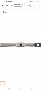

Place throating reamer in throat and rotate backwards so the reamer rises up on lands at beginning of throat. measure the distance the shank of reamer protrudes fom rear of barrel, ( preferably with a depth mic) subtract distance you want to move throat forward. Secure small adjustable tap handle to shank of reamer with face of tap handle closest to the barrel at desired measurement muzzle straight down chamber up and rotate clockwise. Use thumb and forefinger on rear of reamer shank to turn it not the tap handle. All the tap handle does is act as a stop. When tap handle reaches rear of barrel you're done! KISS principle!
